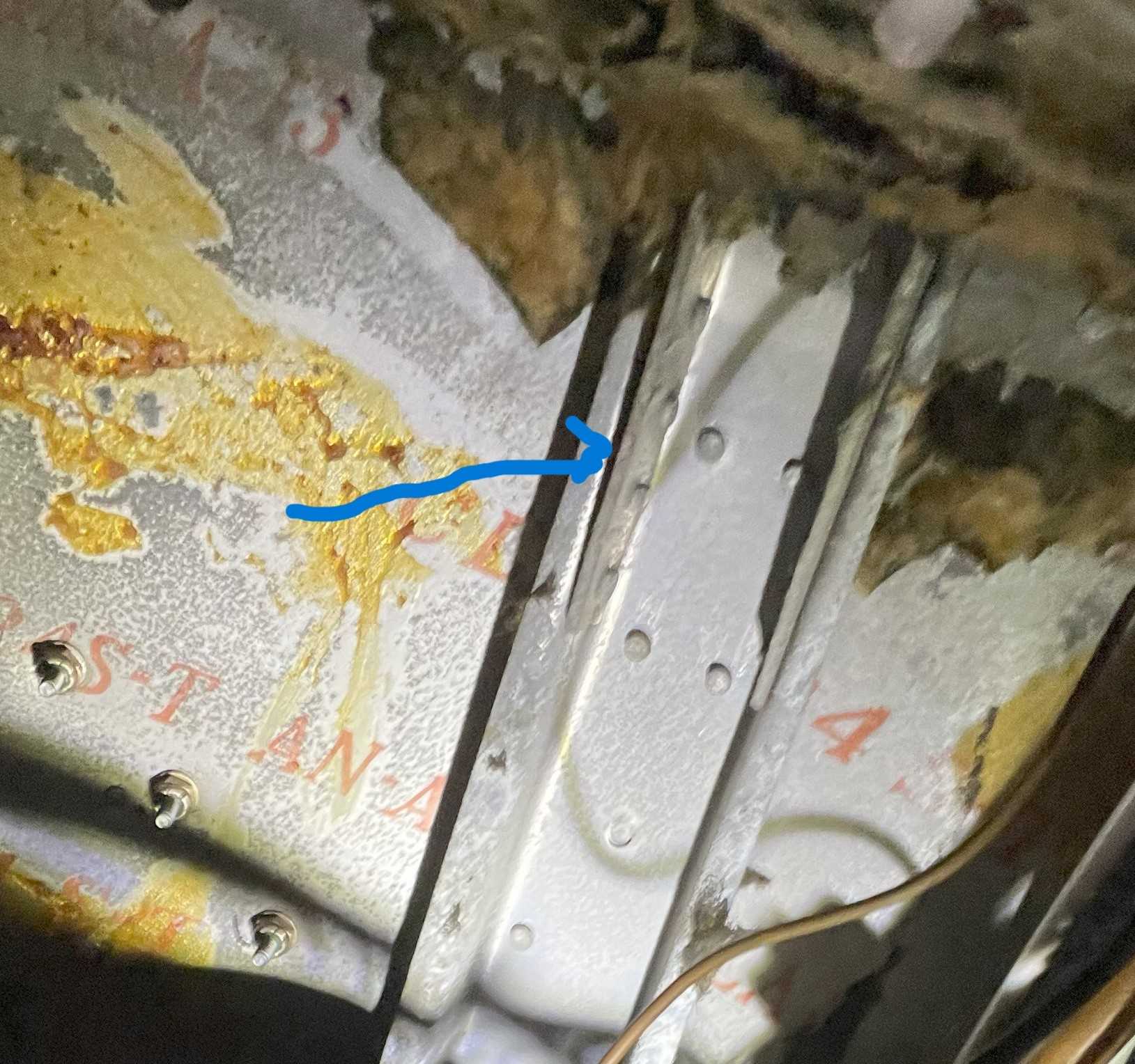

My company is working on a Cessna 140 that is showing major granular corrosion on the brackets mounted inside of the upper firewall that the engine mount attaches to. The parts manual that I downloaded from this sight does not specifically show these brackets, however on Figure 17, #24 and 25 points to where these brackets are. The description is angle, firewall reinforcement, so I am not sure if these are the brackets. I would be grateful if someone out there can help us pinpoint the brackets that we need. Thanks.

Do you mean the stringers? If I recall correctly, there is a stringer at each engine mount attach point, numbers 9, 10, 11, 12 and 13 in figure 17.

There are stringers, but there is another bracket that attaches to the stringers that support the engine mount.
- IMG_1095.jpg (238.03 KiB) Viewed 5616 times

Okay, I looked up the P/N for the stringer/engine mount and see that it has that part attached. Thank you John for pointed me in the right direction.

Why didn't I think of that? I just looked at the pictures...smtschirhart wrote: ↑Fri Dec 08, 2023 11:50 amI looked up the P/N for the stringer/engine mount and see that it has that part attached.
Check the stringers for cracks. There was a write up in the EAA Vintage mag, or something similar, about 35 years back, about a mysterious buzzing noise behind the panel.
