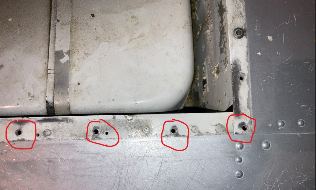

I got the fuel tank cover skin removed on the left wing, and found some things. My IA and I are surprised and concerned with the holes that were drilled and tapped through the spar caps (both front and rear) for the screws which hold the skins in place. They appear to have been threaded for #8 machine screws which were at some later date replaced with sheet metal screws presumably because the original threads stripped out. Needless to say, not what I was hoping to find. Questions going forward:
- Did the Ruleto metalization drawing package specify drilling and tapping holes through the spar caps for this tank bay cover skin?
- If so, did they define maximum permissible hole diameters along with minimum distance between holes?
Assuming the holes can be there in the first place, the preferred solution is to drill out each hole just enough to remove the threads and reduce points for cracks to start. We can then make a separate nutplate strip that would nestle in underneath the spar cap once new skin screws are installed without doing any further damage. Circled holes in the picture below are the one's we're concerned about.
