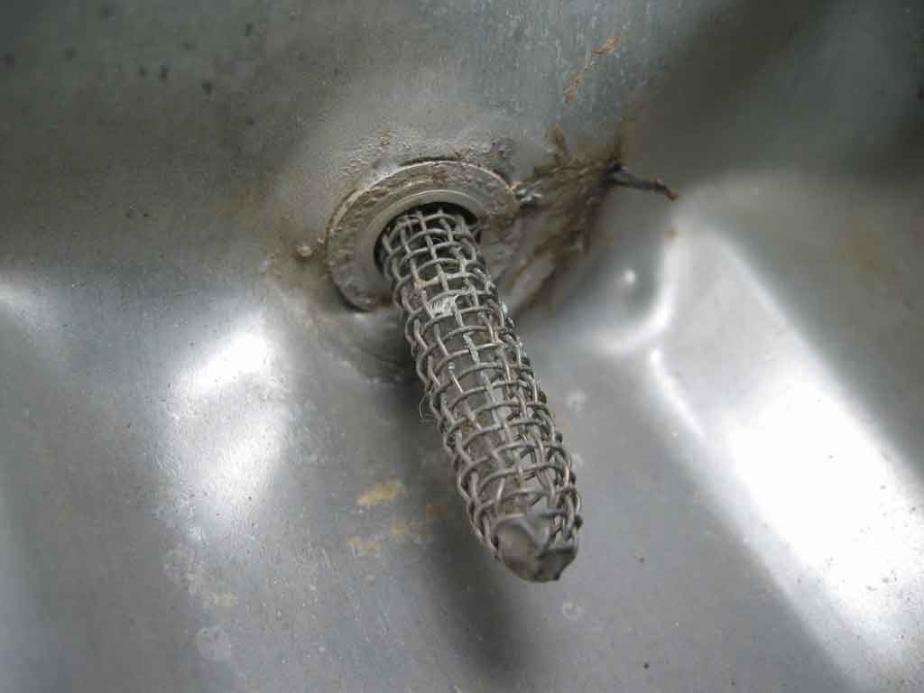

There is a strainer in the tank outlet in the wing root. I think I'd start there. Also, if you can get a camera or "endoscope" inside the tank it's worthwhile to take a look. Disconnect the line at the tank and carb and blow it out.

FInger strainers in tanks

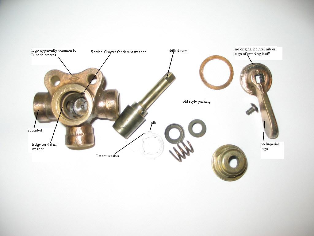

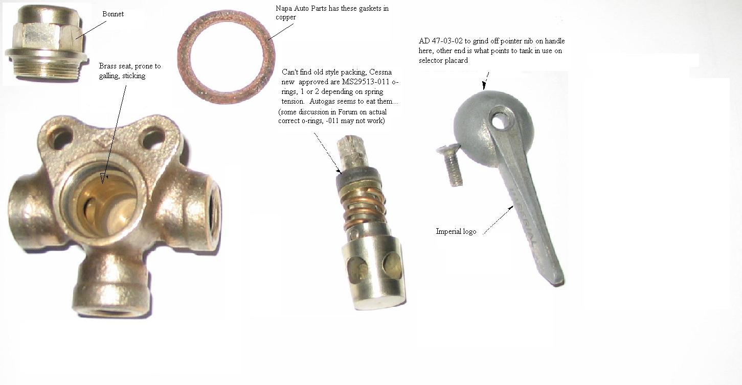

Fuel selector pics, they aren't difficult to work on but John C makes a point about the handle being loose a possibility.

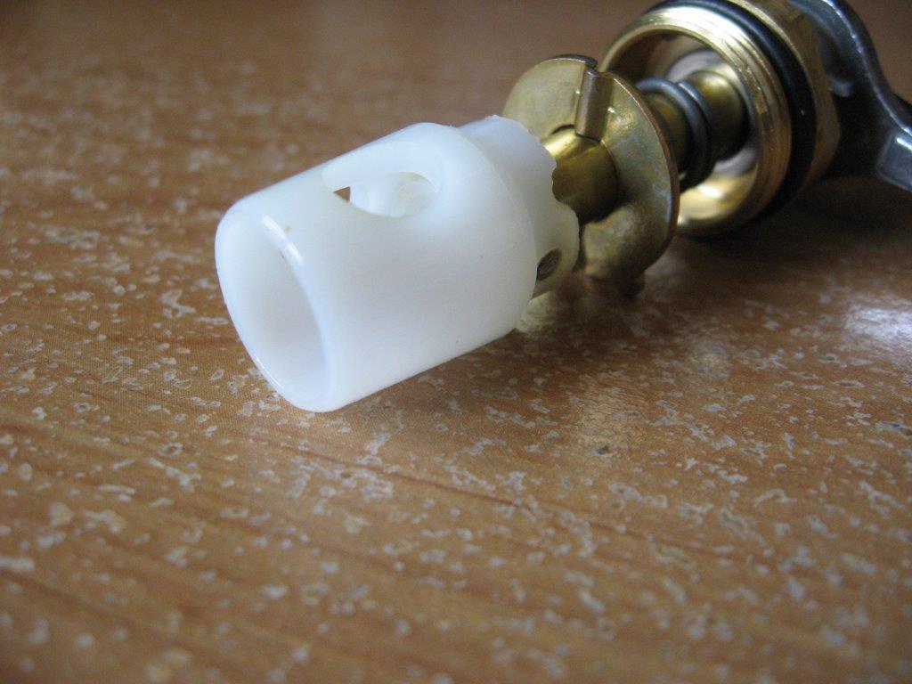

Check to see if you have the old black plug (Jensen) retrofit in your fuel selector. Randy Thompson has a story about his failing. The original Weatherheads had a brass truncated cone that ran against a brass body. When properly lubricated (fuel lube) they worked but would gall eventually. Jensen came up with a polymer plug that self-lubricated which sounded great but apparently they either got brittle or failed somehow. Easy to check, they were black.
- Posts: 2825
Re: Partial power loss
The reported problem with the Jensen plug is that the area where the shaft is pinned to the plug would give way and the plug was stuck in whatever position for the duration of the flight (or glide). They suddenly disappeared off the market. I'm surprised there wasn't an AD issued. I don't know if it was a problem with the part, or if they were being damaged during the installation process.
I recall they were made of Delrin. I though they were white, but that may have been me projecting my experience with another (white) Delrin part. I never actually saw one.
- Posts: 571
The Weatherhead/Anderson 6749 has a white delrin plug

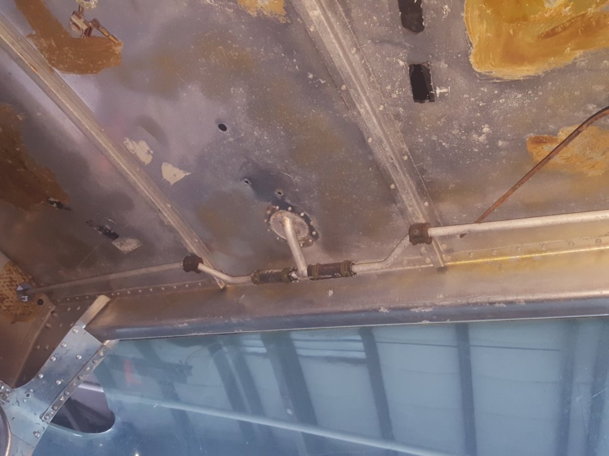

I'm not sure how it would be an issue, but, do you by chance have the tube in the front of the tanks that connects the two air spaces? You should be able to see it (or not) if you remove the forward wing root fairing.
- Posts: 571
What John is referring to, this is the tank inter-connect on a 170A but it's the same idea, and much like the inter-connect on a 140A model. The later 120-140's that had the inter-connect I don't believe had the central breather on the top of the cabin.
