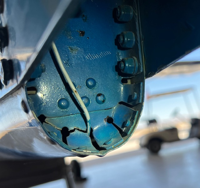

Has anyone made this repair?
- Tail cone.
- IMG_5654.jpeg (114.02 KiB) Viewed 13678 times

That is (was) a repair...
The fact that it failed doesn't bode well for another repair.
(So, the answer to your question is "yes".

I'm certainly not an expert on this repair, but it appears that the bulkhead is .032, and the repair .025. I would think that would contribute to the failure. Now, my eyes are 72 years old, so they may be slightly out of calibration!
Steve H
Steve H

There's a picture of this repair started in the Aviation Market Place forum of this site, in the "1946 Cessna 120 project - price reduced" post.
Click on the restoration photos site, scroll down to the bottom row of the "Maule Tailwheel" section, next to last couple of photos.
Hope this helps.
Steve H
Hope this helps.
Steve H
