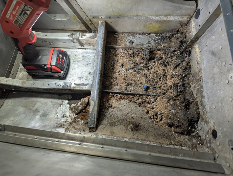

Re: Floorboard cleanout
I got those floorboards out and there was SO MUCH gunk under them.
- PXL_20250906_194402015.jpg (224.84 KiB) Viewed 60917 times
- Posts: 750
That............!! is an impressive amount of "Gunk". You win the award.....and not the one you probably wanted to win!chriscrewdson wrote: ↑Sun Sep 07, 2025 10:00 pm I got those floorboards out and there was SO MUCH gunk under them.
