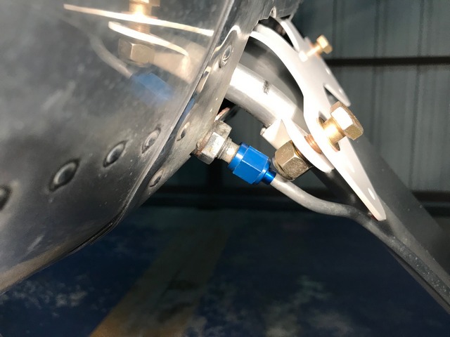

Re: TrickAir Skis
Thanks Dave,
The lower brackets at the top of the gear leg did not fit on mine. I have the later gear (swept fwd). They sent me another set that appear to have been on an airplane before and fit fine. There is a slight taper on the rear of the gear and the bracket must fit that.
Next issue is the shape of the top bracket relative to the bend in the gear at the top. As the bracket is the bend separates the bracket from the gear at the bend by about 3/8". I am thinking this may be on purpose to not stress the shim bolts when the gear flexes. Still working that out.
One main concern is that I don't add any stress risers to the gear leg surface. Planning on wrapping with Teflon tape or this aluminum.
And why didn't I do all this BEFORE it got so cold in the hangar...

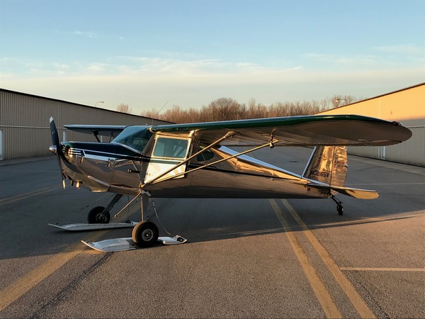

Re: TrickAir Skis
TrickAir 1500 skis installed and flying. Waiting for colder temps and some snow here in Michigan. (never thought I would say that)

Re: TrickAir Skis
Looks cool ! saw some in flight photos hows she handle ? include air speed

Re: TrickAir Skis
I flew it about 1.5 hours so far and no snow landings yet. As far as flying characteristics, I did not see much of a decrease in speed. There was a very slight roll to the right that I can take half a turn on a turnbuckle to correct but probably not worth the effort. In turbulence the increased mass on the gear is noticeable as they move with the turbulence. I did not see any vibration, burble or other anomalies while doing slow flight and stalls. Landing on pavement was similar to landing on the moon. The tires are at maximum pressure (about 40psi) and the bungees tend to push down with the rear of the ski when it touches. So a smooth touch down worked best when doing a tail low wheel landing then bringing the tail up slightly after the wheels touch. They add about 75 lbs at the leading edge of the wing so the CG is further forward, noticeable, and it is a single place airplane. Full fuel and me allows 60 lbs additional weight. Small child.
