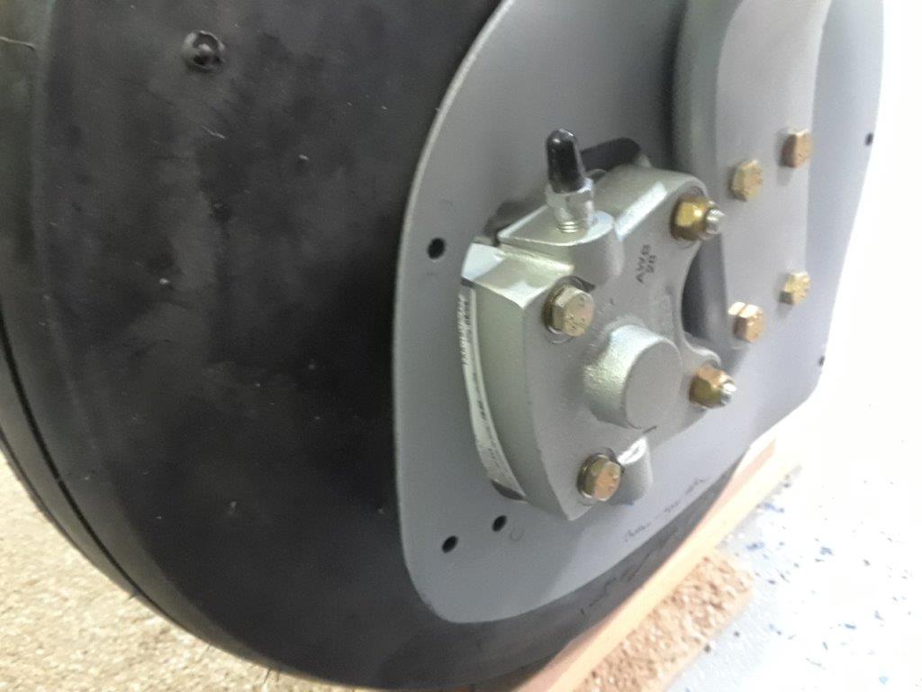

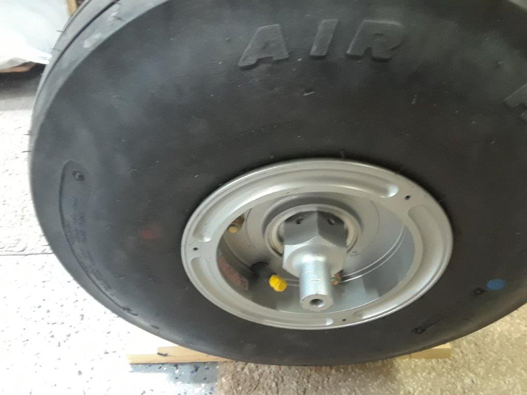

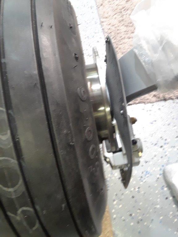

Some photos of my left gear. AN axle bolts are surrogates for now to do the mock-up to fit the wheel pant. I have the high-strength NAS type bolts specified in the IPC for axles drilled for 1/4 bolts.

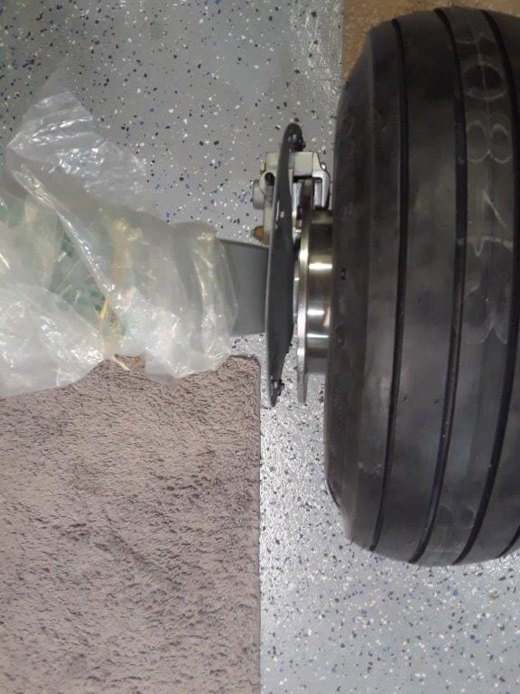

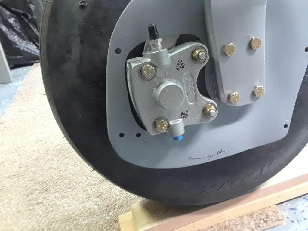

A couple of more photos

That installation looks great! ...sure is clean (compared to my old grungy!!)
There's not much clearance required around the brake cylinder and it appears that you've got it just right. Fitting the pants should now be easy...realtively speaking, of course. Great pics! Mac

Re: Wheel Pant Alignment and Cutout
Dumb question, but is the brake cylinder to the rear of the gear leg? I see that the bleed valve is at the top of the cylinder. Most bleed valves that I have seen are at the bottom to allow easy servicing. Seems like the flex brake line, when installed, might be close enough to the ground to sustain damage due to rocks, etc. I just came across a pair of pretty nice aluminum pants but I don't have the plates or axle nuts.
Yes, my Cleveland brake cylinders are on the rear (trailing edge) side of the main gear spring, and yes I plan to reverse the bleeder screw and place it at the bottom like the many installations I have seen in the field. My Cleveland kit came with the bleeder screw on the top side for the left side, and I haven't reversed it yet.
Two words immediately come to mind when viewing your photos: Incredible Quality! There's often talk of some of our 120s/140s being "better than Cessna made'em" -- yours is headed for being the "poster child"! Thanks for sharing the details of your work and progress with us. Mac
