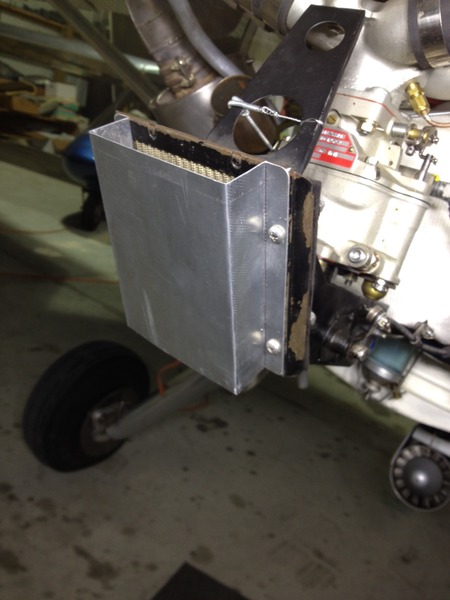

Engines just suck what air it needs for the fuel and HP. produced , Ram air when you prematurely close the carb heat (turn it off )in a low RPM condition like gliding to the runway for a landing you are than using ram air instead of engine baffled air, it is a known cause for idle problems and engine stoppage ( this has happened to me ) on a Stromberg . below are two approx. calculations for air flow, A Stromberg is a CV carburetor their is no accelerator pump and the C-90 is one of the biggest engine this series of Stromberg carbs is on. I also attached one doc. from Continental & Stromberg and a picture, these two bulletins came out ( about 65 or so years ago ) they work as well today as they did 60 years ago
The AP/IA that i got these from does the modification that the picture shows on every small plane he works on.

- carb plate.jpg (56.24 KiB) Viewed 5332 times
- ContinentalSB-M64-6.pdf
- (104.82 KiB) Downloaded 926 times
- bullentin 74.pdf
- (203.92 KiB) Downloaded 780 times
