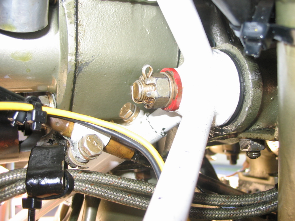

Something like this? Sorry can't help on a source....
- Mike&HarlansPlane1 (6).jpg (380.72 KiB) Viewed 33492 times

Re: "Special" Motor Mount Washers - AD 46-44-05 SLN-18
Yes, but the logic is to shift the bearing surface from the flat washer in front to the back side of the tube. I'd suggest you go ahead and have the washers made up if you don't find them with your parts.
Thanks much for the photo. The washer is very evident - especially since someone was kind enough to mark the edges! The only notable difference between the picture and the drawings in Service Bulletin 18 is the direction of the bolt. I reckon that doesn't really matter much.
Interestingly, it turns out our airplane falls outside of the serial numbers for the AD, so apparently by the time our airplane (Serial 10038) was born the change had been incorporated into production.
