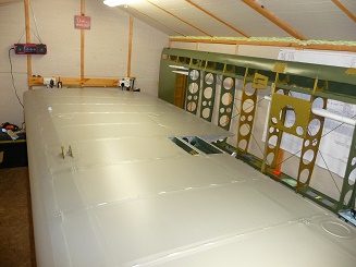

Oratex... Its the future of wing covering.
No painting, no fumes and very light.
- cover37.jpg (47.49 KiB) Viewed 12218 times
