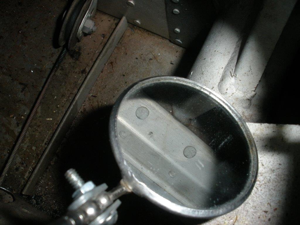

Re: Landing gear boxes
Thanks for your response. Through the mirror the crack can be seen at the upper angle support weld.
- Crack along the edge of the weld
- 4-12-19 001.jpg (98.86 KiB) Viewed 14940 times
It appears that the material is steel.
If it is removed I would think a good welder would be able to fix it.
It will not be easy but I would think it do able.
Hi Rick.
"Is this 120 considered scrap with the gearbox cracks..."
No, the cost of repairs will not be equal to the value of your airplane. I have removed a damaged gearbox from a C140, had it repaired, and put it back in. It took a lot of hours and if I would have had to pay for those hours at the going rate of a repair facility, I probably wouldn't have been able to afford it. (I live on a pretty tight budget!) My IA kept a close eye on my work, and then did the paperwork and signed off the repair.
So the question you may actually be asking is: "Can I afford to fix it?" I bought the plane with the broken gear box for 1/3 of what I sold it for after flying it for 300 hours over a 10 year period. You would probably take a pretty good hit if you sold the plane with the damaged gear box. Get with an IA who has experience with repairing these planes and he should be able to give a ball park estimate of the time involved. I bet Victor G, who answered your original post would be great to work with if possible! The actual box repair will be relatively inexpensive...it'll be the coming out and going back in that will cost you! However, if you can do the work yourself, it won't be near as traumatic!
