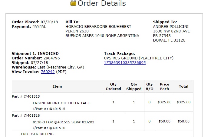

I discovered last year that the C150 that flies for school in our Aeroclub did not have a spin oil filter.
I suggested to install one, and we ordered it at AircraftSpruce.
Is installed as per the STC documentation and works nicely.
I attach the ASpruce order for documentation.
Have a very nice day !
Horacio

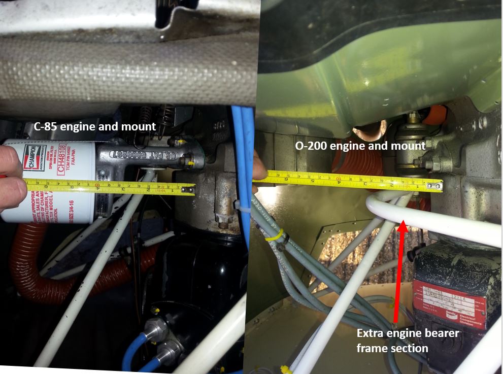

my concern is with the curved part of the engine mount for the O-200 on my Cessna 120, which is an extra part that the C-85 mount does not have. Can you tell me if the mount on the Cessna 150 has this same piece (see attached picture) ?

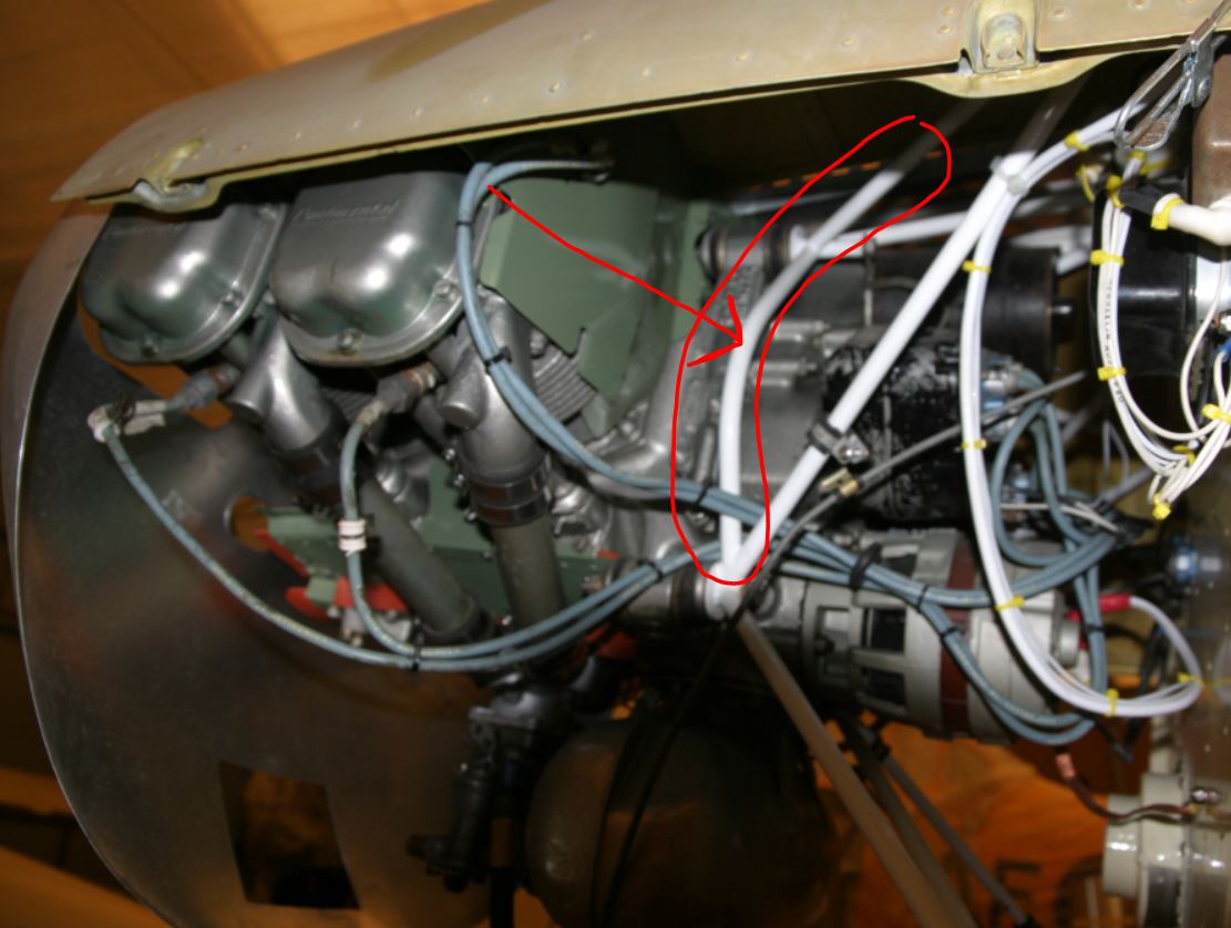

My 120 with an O-200A has a curved section to the engine mount frame, which (I believe) will not allow the TAF-L spin on oil filter adapter to be fitted.
Are all O-200 to C120/140 engine frames this way ?

The measurements in Post 3 would seem to indicate it will fit. Hopefully, someone will post a photo showing the filter and mount together. Or, Randy might know.

I think the TAF-L was made to fit with the O-200 Mount. (0451111) I can’t seem to be able to attach a photo. I measured my distance from the engine to the mount outer rim and got 2 3/8 inch. The filter adapter, TAF-L allows 3 inches. I don’t run filters, but I have a few I have removed, and I could take these measurements.

Re: Tempest spin-on oil filter adapter
I have an 0-200 on my 140 with this oil filter adapter. My engine mount has the curved piece installed.
