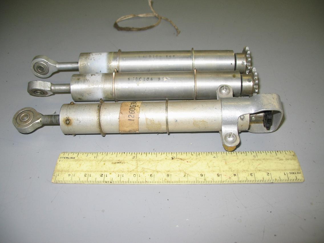

Re: Trim actuator
I installed the #1260074-1 unit after my old actuator showed way too much play and I had some flutter. It was a drop in replacement. That said, the movement on the trim wheel was much more sensitive and it took less 'turn' to achieve the same response from the old unit.

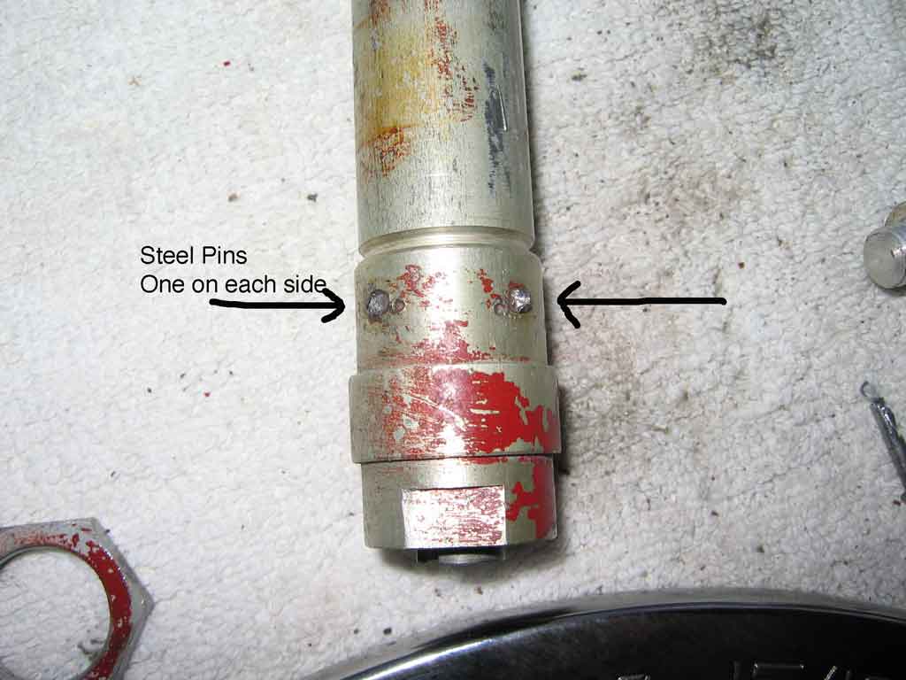

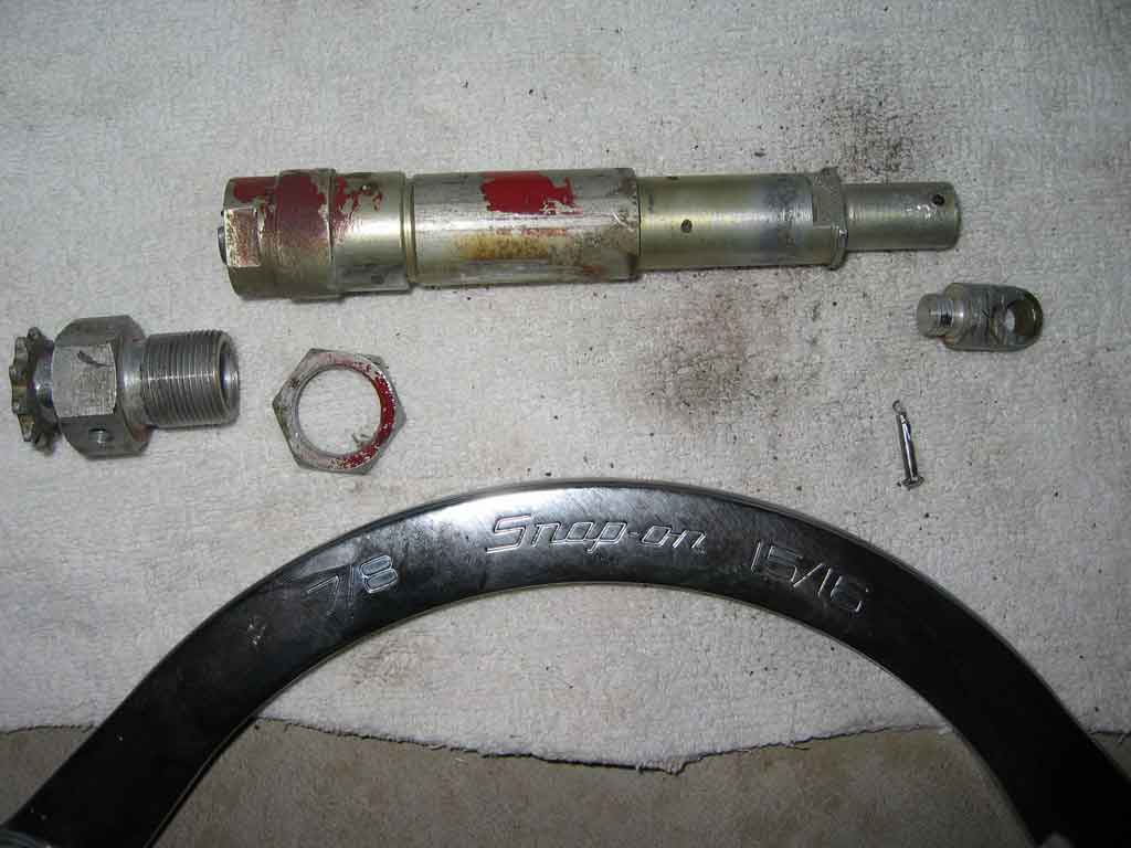

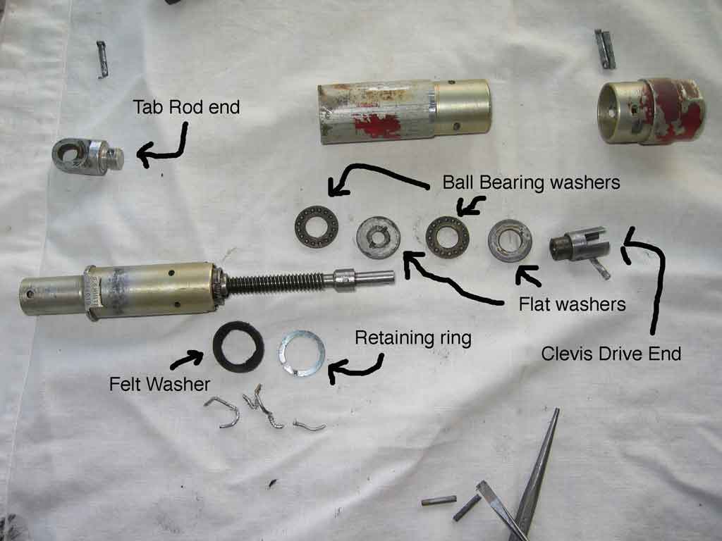

I thought at some point we had a thread with pictures of a member that had opened one and restored the over-spec pieces.
I may have those pictures on my computer at home. That will have to wait for another week before I can get them on this thread.

- Posts: 571
Re: Trim actuator
Beat you to it...
- largeendpins.jpg (50.79 KiB) Viewed 7995 times
- assembly.jpg (45.54 KiB) Viewed 7995 times
- allparts.jpg (35.69 KiB) Viewed 7995 times
