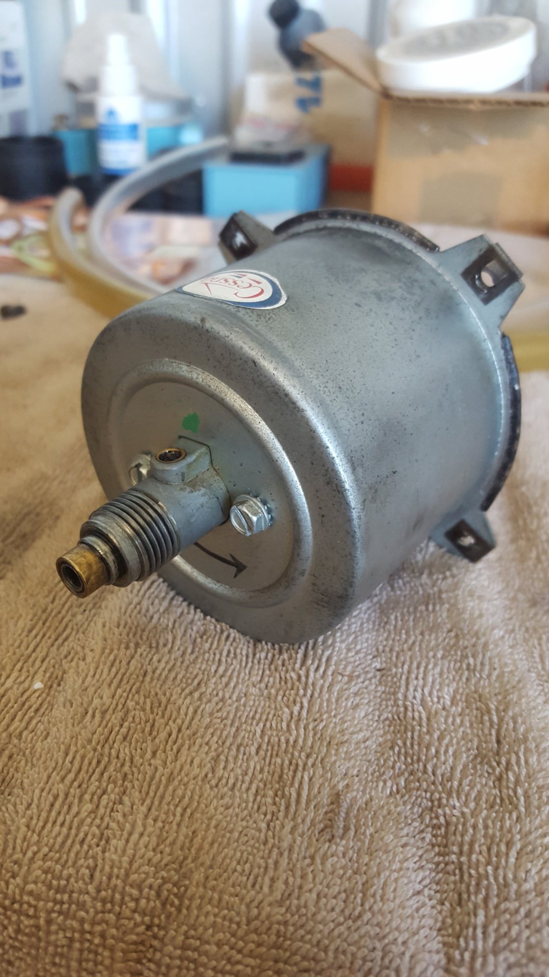

1. Have your A&P lubricate the tach cable
2. Check for oil pot on back of tachometer, if it has one then use a very fine oil, your A&P oughta know, see pic....
- 20191001_122849AAA.jpg (300.36 KiB) Viewed 10224 times
