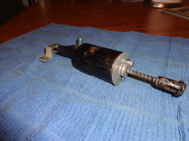

Can anyone identify this. The top screws on. I bought a seal kit that I thought would work but it was wrong.
Also the threads are messed up on the elbow. Anyone know where I can find a new one. It's a -3 flair X -4 Oring boss (AKA SAE).

That's the classical original cylinder on the 120/140. Suggest before you think new _$$$$$$- get the right O ring and replace the elbow and try yours. It was originally set up with parking brake capability which has obviously been removed - note the slot in the "hat" section of the screw-in cover - that was where the arm was located that engaged the slotted stem to keep pressure on the brake for parking. System caused problems for some, so was removed to preclude accidents!
John C et al will be on and give part # for proper O ring, etc and their recommendations.

AN6227-7 or MS28775-012. The cylinder is a very simple design and the o-ring is the only wear part. There is a little pin that cocks the o-ring at the top of the stroke to allow fluid in and out of the reservoir. The o-ring takes a set over time and doesn't seal properly.
The elbow fits to the cylinder with an AN902-4 gasket, which, if memory serves, is a rubber washer, not an o-ring, with a flat cross section.

Thanks for the info guys. Just what I needed.

Oh, yeah, the elbow is AN921-4D and the nut is AN924-4D.
