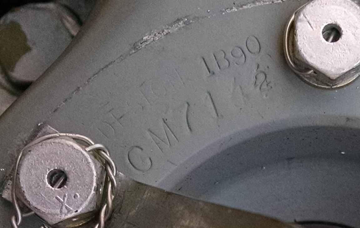

That's beyond shallow! What is the prop length? What is your static RPM?
Here ya go....from a distant past owner. I am guessing he had a 71" prop from his old C85 installation and wanted to use it for the 0-200 installation. Static right at 2400.

Prop History-
7-22-82 overhaul CM71/45 1B90
9-15-82 installed on C85
6-26-84 re-pitch from 45 to 48"
1-25-88 re-pitch unknown spec
9-5-90 re-pitch to 42'
3-14-05 overhaul, 2 stations out of spec, kept 42"
I like your second gear analogy. I did check the airspeed indicator and against the GPS and I'm pretty much in the 100-105/110 range.
Next prop overhaul if I live that long will consider 44"

There are rules about how many times you can repitch it, and how many changes of direction are permitted. It's already gone from 45-48-X-42 (that we know of). Are there a lot of numbers stamped on the hub?

I think I'll check the serial number. I'll also look at the old prop logs for that unknown pitch. I only see a 44 to 42 change here.
