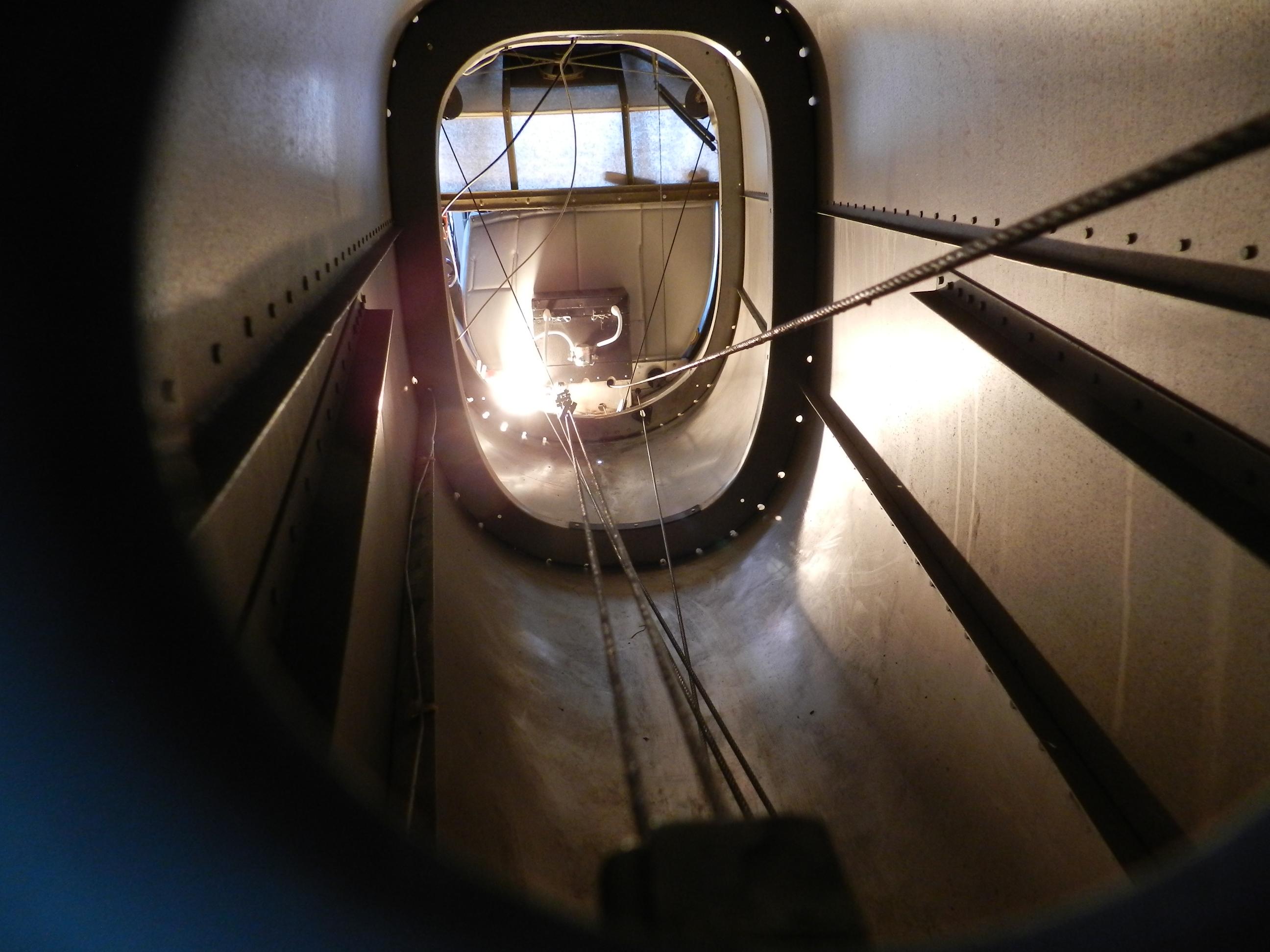

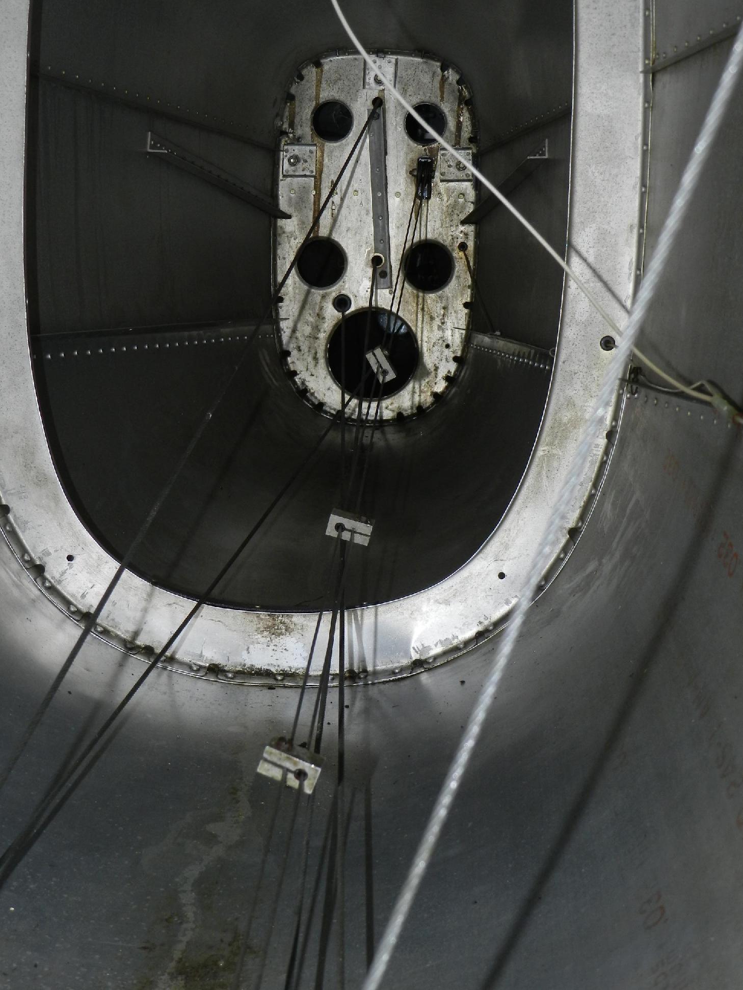

Does anyone have a picture of all the cables running to the back of the airplane it will be much appreciated. While taxiing around they rattle around like crazy, is this normal?
- Posts: 568
Re: Just purchased 1946 140
Here ya go.
Maybe check your rudder return springs? Just a guess. They are under the cockpit tunnel, see the parts manual figure 20-9.
- 5-25-12 004.jpg (357.01 KiB) Viewed 9054 times
- 5-26-12 neutral.JPG (286.59 KiB) Viewed 9054 times

Mine look the same as yours, the second bulkhead in your first pic looks like it has a pad, or extra strip on it. Is it rubber or aluminum?
frog
- Posts: 22
- Joined: Mon Dec 19, 2022 9:33 pm
And thanks for the pics and advice on the springs
- Posts: 568
Originals were a sort of phenolic compound.the second bulkhead in your first pic looks like it has a pad, or extra strip on it. Is it rubber or aluminum?

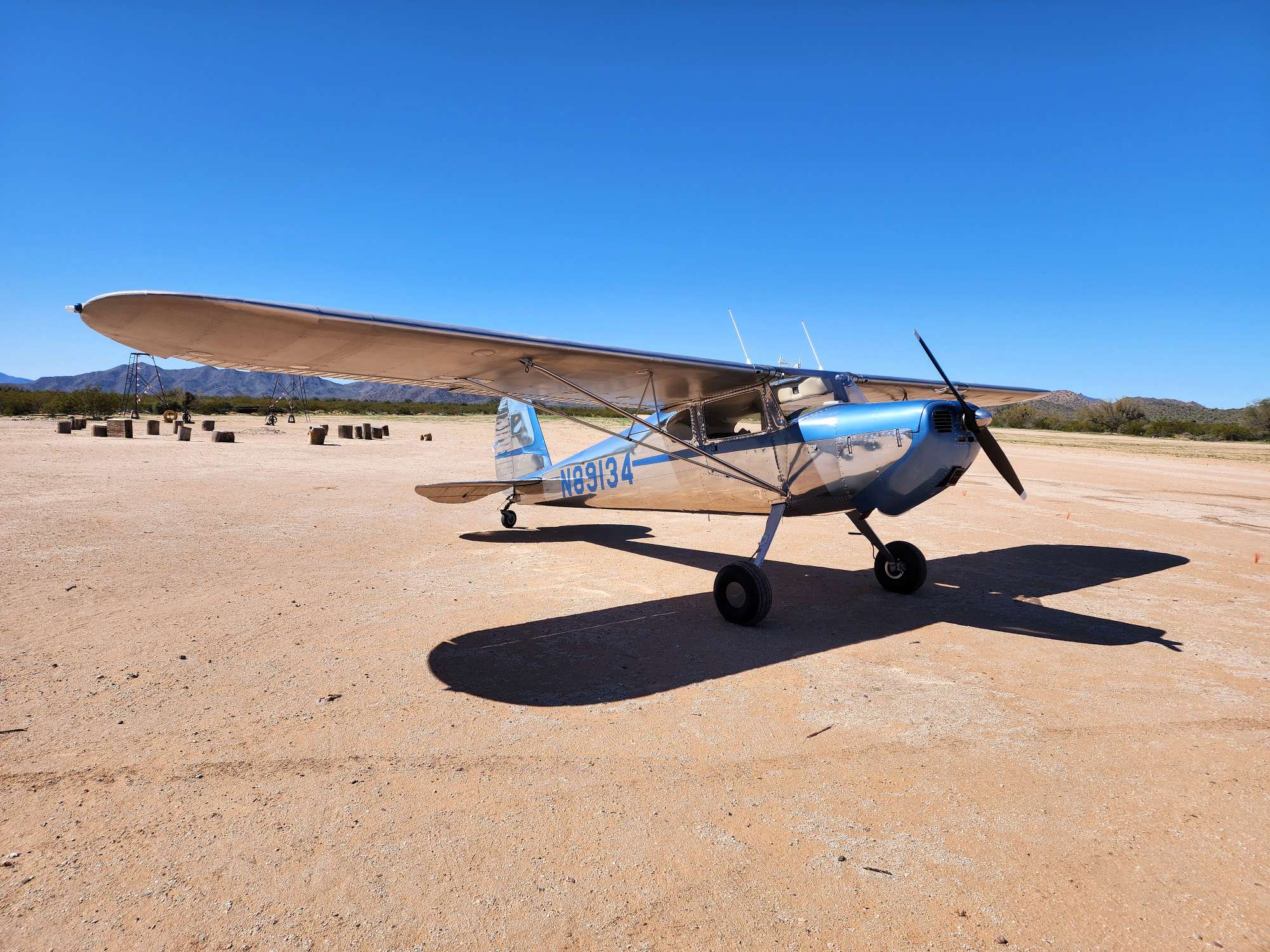

Really enjoying flying the 140
6478
- Posts: 68
- Name: Dean DeRosia
- Location: Glendale, AZ
Where was this taken? Looks like fun!
