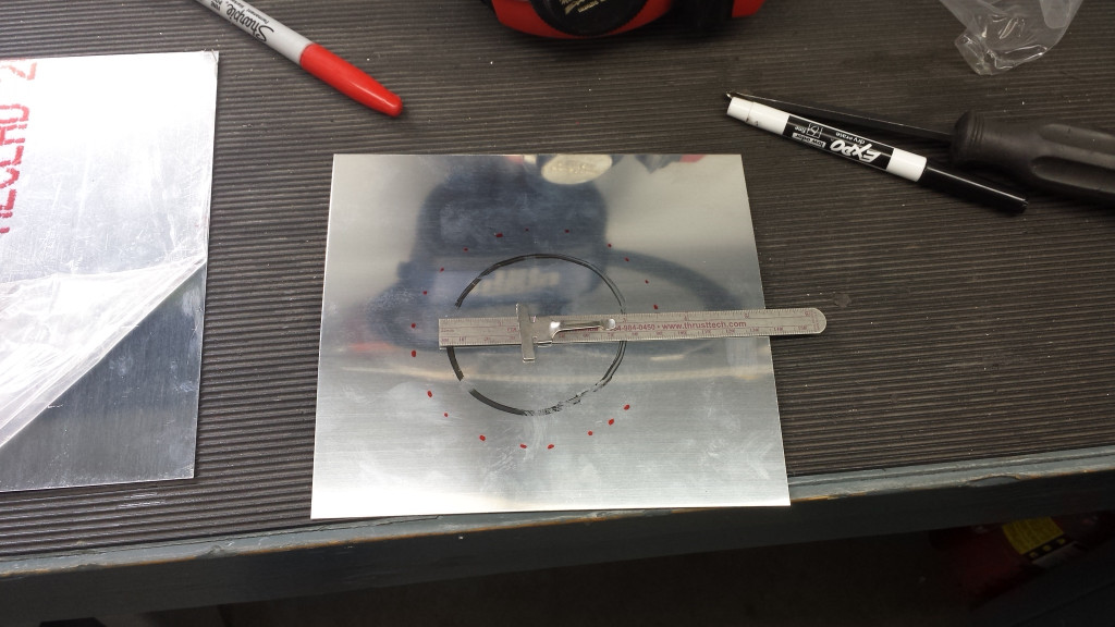

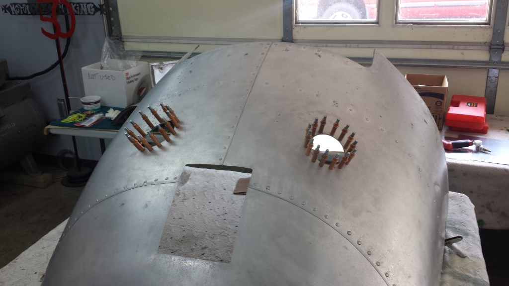

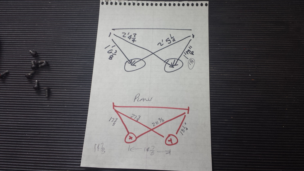

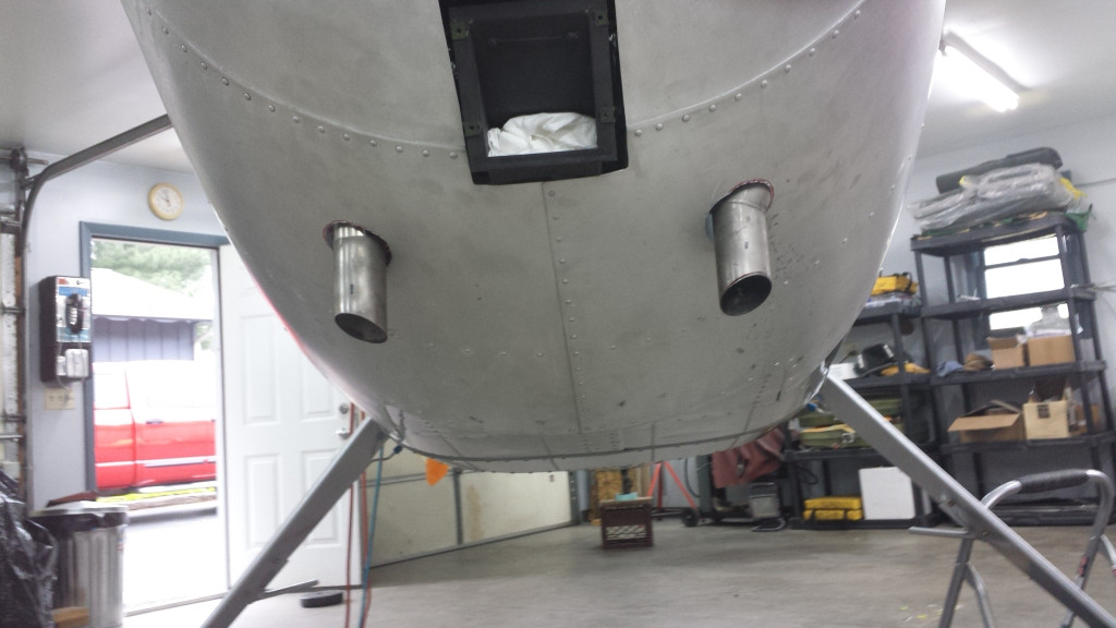

Prior to heading out last Thursday, we got brave and cut the holes in the lower engine cowl, for the 150 style exhaust pipes! I tried the "drop a plumb bob to the floor and then back up to the cowl" method, but just didn't trust it. I couldn't level the plane in my shop, as the ceilings are only 8' tall, so it just didn't seem to work.
So I triangulated from the lowest common screw hole, and got some pretty reproducible readings, then we just closed our eyes and hole-sawed away. After some more opening with the die grinder, we were clear of the pipes. I need to finish grinding to a common clearance around the pipes, then reinforce the holes. I think we're in good shape.
So then we triangulated from the lowest cowl installation screw hole. This seemed better/more accurate/repeatable
Then just fearlessly cut holes in your 68 year old, unobtanium lower cowling! It actually went well.

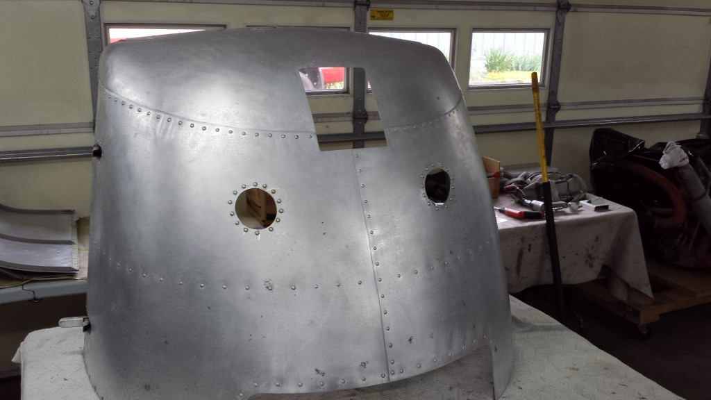

Finished the doublers around the exhaust pipe exit holes in the cowling. Great to have this done, as Pro Painter Greg was back over last night, to review plans for painting the cowls and remaining parts of the airplane. Remember that he painted the fuse late in October on the last warm day we had here in Michigan. Will be fun to finish the pieces.

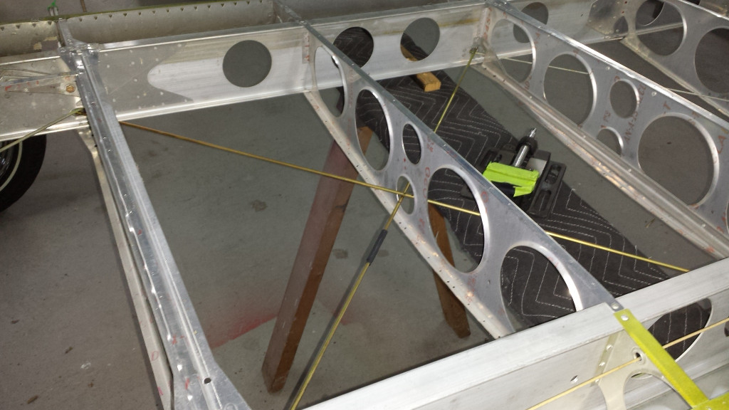

On to the wings now. I'm installing the outer bay new drag wires, beautiful pieces from Univair (and they ought to be).

Cut out by hand
Cut out by hand
Cleco in place
Cleco in place
Riveted on
Riveted on
Working on the Drag Wires

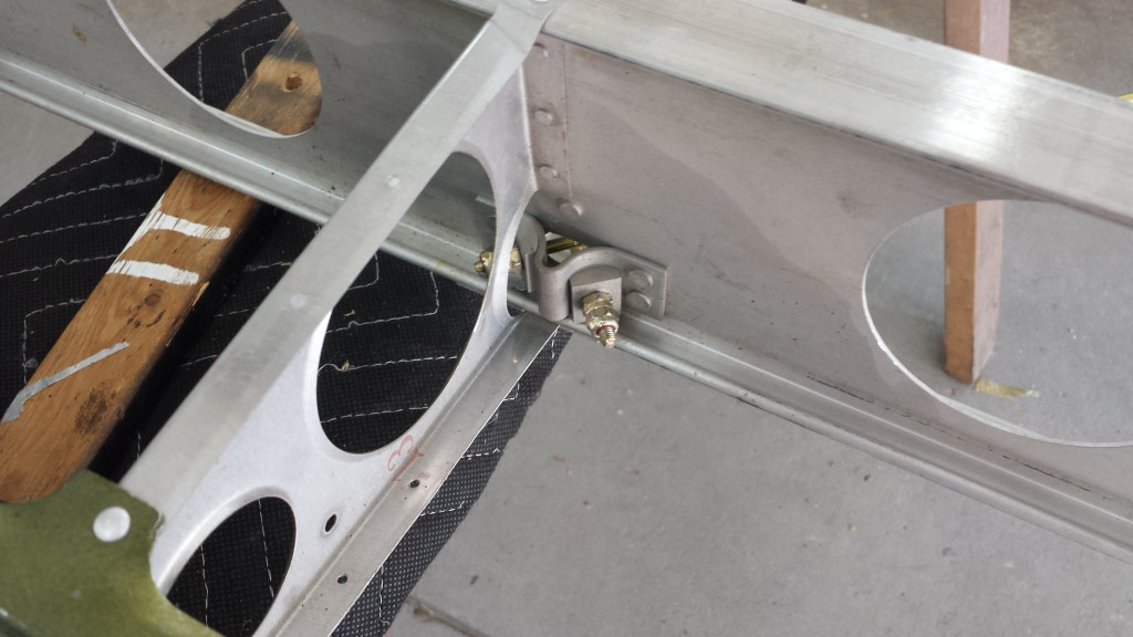

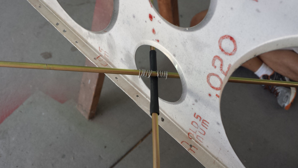

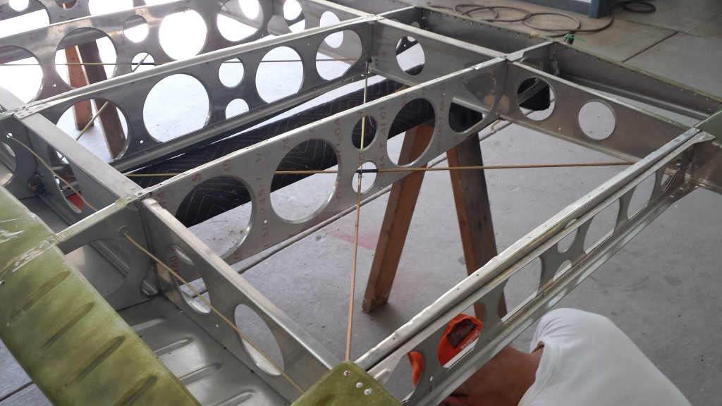

Back to the installation of new drag wires in bays 3 and 4. It's a good two man job given all the trammel measurements to be taken as you draw the wires taught. The old wires and pivoting blocks looked great, and actually the whole wing structure looks pretty darn good, no corrosion or damage or signs of ugliness. I'm ready to re-install the tanks, need a new Pitot tube, am adding the cabin vents, and a Leading edge landing light. Will be ready to re-cover them soon.
New drag wires in the outer two bays
Wires use standard locking nuts
Wires tied at the intersection

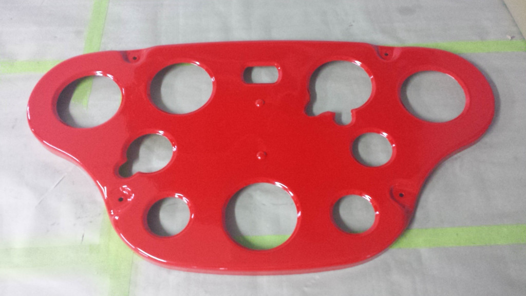

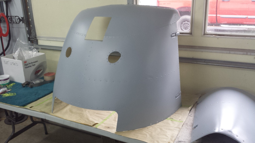

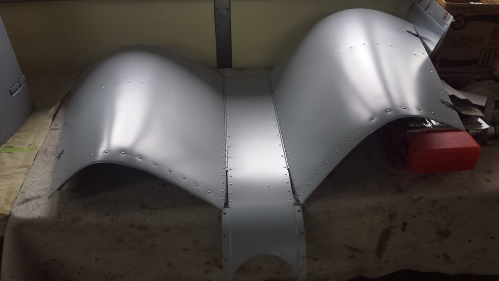

Primed the engine cowling's, they turned out great. Worked out a couple of small dents, and the topcoat of primer is sandable on the outside. Next step is to paint the red on the top cowling, then install everything and mask for the striping. should look great. Also painted the gauge panel, and stuck it in place to stare at as well.

Primed lower cowling
Primed upper cowling
